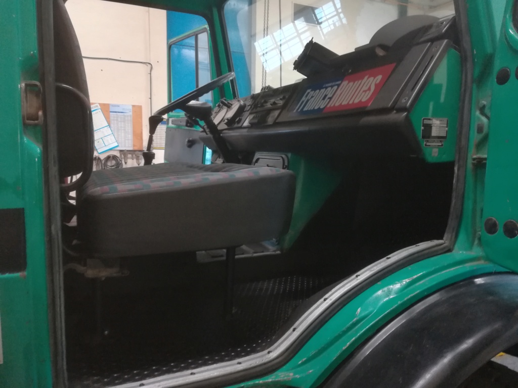

Remontage siege passager
435 - Page 12 Img_2115
