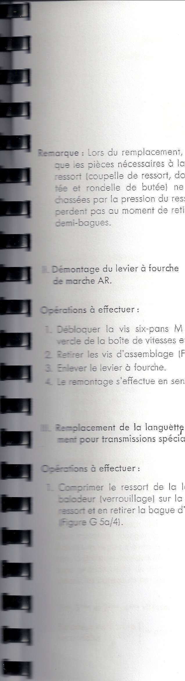

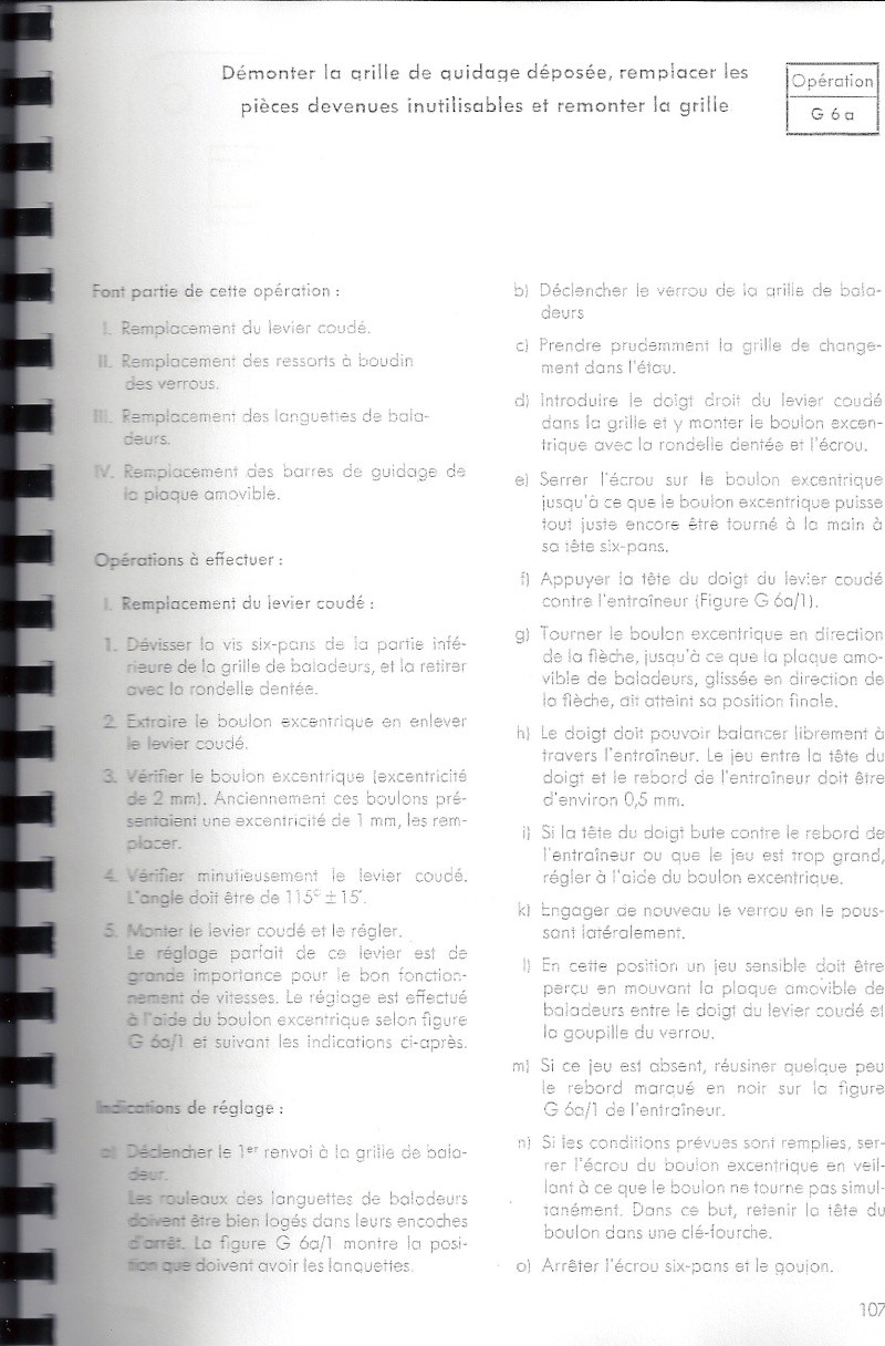

[/url[url=http://www.servimg.com/image_preview.php?i=14&u=15490761][/url[url=http://www.servimg.com/image_preview.php?i=15&u=15490761][/url[url=http://www.servimg.com/image_preview.php?i=16&u=15490761][/url[url=http://www.servimg.com/image_preview.php?i=17&u=15490761][/url[url=http://www.servimg.com/image_preview.php?i=18&u=15490761][/url[url=http://www.servimg.com/image_preview.php?i=19&u=15490761][/url[url=http://www.servimg.com/image_preview.php?i=20&u=15490761][/url[url=http://www.servimg.com/image_preview.php?i=21&u=15490761]
ça te servira tot ou tard geek
si tu as besoin d'autres éclatés etc... tu n'as qua demander

attention, c'est l'éclaté d'une boite de 401/2010, non synchronisée
