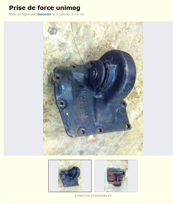

If you don't have that on your gearbox,no shafts power,you need it!
It's what your short lever put in action to make shafts turn...

YES,you can have the small lever and have no shaft ,that is possible!
To have shaft you need :
Unimog 401 Westfalia 1955 - RENOVATION Bv1010
the small lever action this,you can have the small lever and have not this,this is possible.(it's exactly the same for 411 and 421 )
like I said before you need :

I think we need more pics to check wether you have the PTO on your gearbox or not. If it is installed on the gearbox, you only have to find a lever or one unsyncronised gearbox to take the lever...I think this won't be easy to find as an original part!
You can check my gearbox on the restauration of the Wabymog
http://www.unimog-mania.com/t8481-the-future-new-wabymog
Kind regards
Waby
